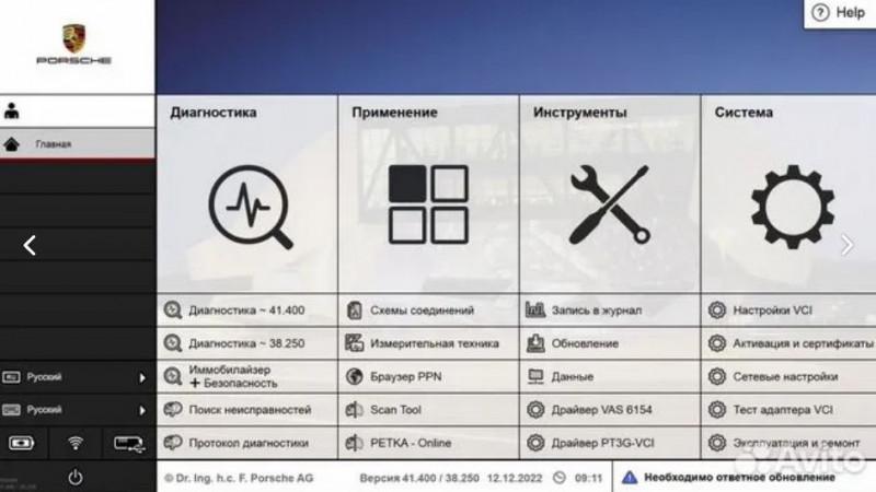

Porsche Piwis 41.600 + 38.250 под VAS 6154 (Easeus Image) [2022]
в Diagnostic and repair programs
